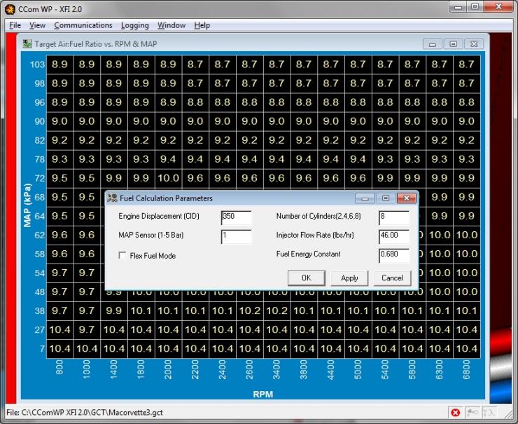

Eagle1_77 Posté(e) le 9 juillet 2014 Auteur Signaler Posté(e) le 9 juillet 2014 Ben vous savez quoi les gars. Je suis bien content d'avoir acheté ce kit FAST car figurez vous que l'on peut adjoindre un FlexFuel Sensor qui permet une fois validé dans le programme du calculo de mesurer en temps réél le FEC. Qu'est ce que le FEC ??? c'est le Fuel Energy Constant. Voici une explication tirée de l'aide en ligne de mon soft 6.3 Fuel Calc ParametersThese parameters must be filled out correctly to ensure proper engine performance. If for any reason you cannot find any part of the information needed below, please contact your FAST™ dealer or a FAST technician on our EFI Help line, 901-260 FAST. You can also receive technical assistance by email at support@fuelairspark.com. 6.3.1 Engine Displacement (CID) This parameter is a part of the ECU’s calculation to determine the amount of fuel to inject when running in Speed Density mode. Enter the engine’s displacement in cubic inches. This must be entered correctly or the engine will run richer or leaner than intended. 6.3.2 Map Sensor (1-5 Bar) This parameter is used to scale the readings from the MAP sensor. MAP sensors are rated by their maximum sensing range. A 1 Bar sensor can read up to one Bar of pressure (atmospheric pressure), a 2 Bar sensor can read up to two Bar of pressure and so on. Enter a number between 1 and 5 that corresponds to your MAP sensor’s rating. 6.3.3 Number of Cylinders (2,4,6,8) This parameter is a part of the ECU’s calculation to determine the amount of fuel to inject. Enter the number of cylinders the engine has. This must be entered correctly or the engine will not run correctly, if at all in some cases. 6.3.4 Injector Flow Rate (lb/hr) This parameter is a part of the ECU’s calculation to determine the amount of fuel to inject when running in Speed Density mode. It is also used for fuel flow and mileage calculations. Enter the flow rate of the injectors in lb/hr. This must be entered correctly or the engine will run richer or leaner than intended. Keep in mind that fuel pressure affects flow rate. When manufacturers rate injectors, it is at a certain fuel pressure. Injectors from FAST are rated at 43 psi (taller, traditional style) or at 58 psi (shorter, GM Gen IV style). If you are using a different fuel pressure, the flow rate of the injectors will be different. A simple equation can be used to estimate flow rate at a different fuel pressure: New Flow Rate = Old Flow Rate x square root of (New Pressure / Old Pressure) 6.3.5 Fuel Energy Constant This parameter is a constant that defines the energy properties of a given fuel as the difference between it and gasoline (see table below). This strategy allows us a comprehensive range of fuel types and mixtures. The XFI ECU will compensate the fuel delivery based upon this parameter. While using the Lambda display mode will be more uniform in the display of the air/fuel ratio with different fuels, C-ComXFI will otherwise display all air/fuel ratios adjusted to the Fuel Energy Constant. Please note that the injector flow rate is still entered as lb/hr but as normally rated with gasoline. Fuel Energy Constants (FEC) for Common Fuels Fuel Type FEC Stoichiometric A/F Compressed Natural Gas (CNG) 1.17 17.2:1 Liquid Propane (LP) 1.07 15.7:1 Gasoline 1.00 14.7:1 Methyl Tertiary Butyl Ether (MTBE) .796 11.7:1 85% Ethanol/Gasoline Mix (E85) .680 10.0:1 Ethanol (ETOH) .612 9.0:1 Methanol (MEOH) .439 6.45:1 6.3.6 Flex Fuel Mode If you have one of FAST’s Flex Fuel sensors, you will need to check this box. This will enable the ECU to use the feedback from that sensor to determine the exact Fuel Energy Constant in real-time. Citer

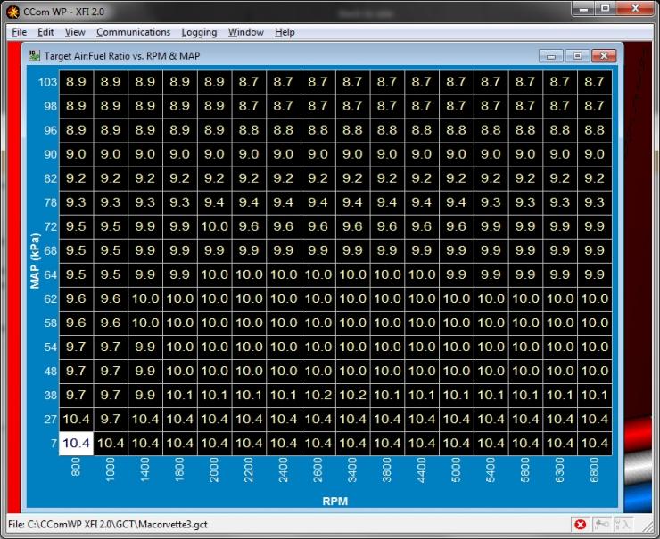

Eagle1_77 Posté(e) le 9 juillet 2014 Auteur Signaler Posté(e) le 9 juillet 2014 Voila, j'ai parametré à 0.680 le FEC et automatiquement il a adapté la carto Citer
Eagle1_77 Posté(e) le 9 juillet 2014 Auteur Signaler Posté(e) le 9 juillet 2014 En positionnant le FEC à 0.680 pour le E85 Citer

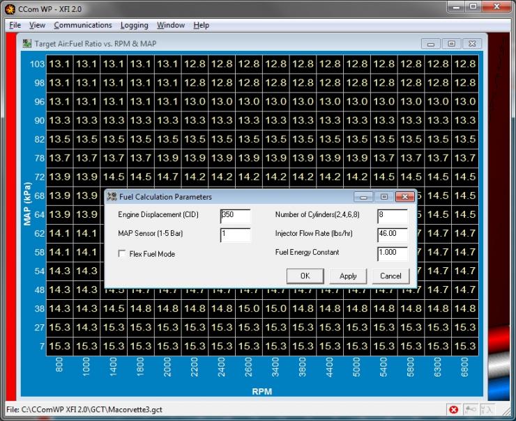

Eagle1_77 Posté(e) le 9 juillet 2014 Auteur Signaler Posté(e) le 9 juillet 2014 Et ca, c'est quand le FEC = 1 dont le SP standard Citer
